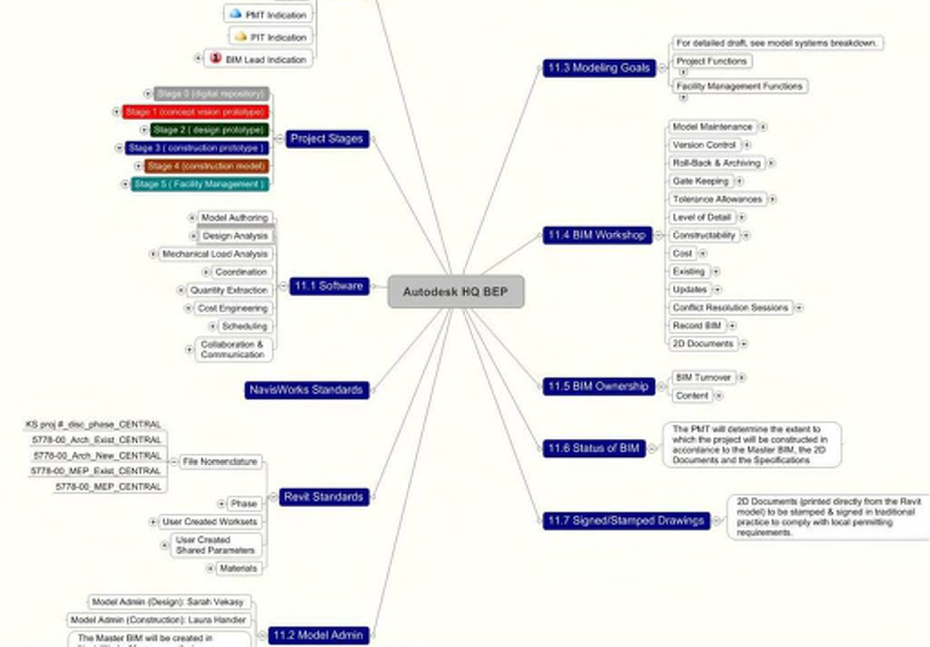

BIM-Enabled IPD requires a shared model between design and construction. There is no "our model" and "their model". We used several Revit files to comprise our model. Our models were organized by discipline; everyone had access to everything, at all times. (See Figure 1).
Figure 1: The project’s BIM Execution Plan (BEP) developed by Tocci, KlingStubbins and Autodesk
Before any modeling happened on the project, Sarah & I sat down to establish and negotiate all of our BIM Standards, which we documented in our BIM Execution Plan (BEP), see Figure 01. We had to figure out technical Revit things like worksets, phases, and browser organization, but other, more "social" processes, for instance, protocols for when a central file crashes. We also though out some way to achieve "gate keeping" (translation: to make sure that I didn’t inadvertently move anything I wasn’t working on), but we didn’t end up using any of them because there was so much trust in the team.
One of our major planning activities was merging our individual Revit templates to create a project template. We mostly used the standards we developed and documented in our BEP, but we did run into some issues that we hadn’t considered. For instance, we had to figure out how to handle the project number because we have different project numbers (it actually wasn’t the world’s most creative solution - we just added a parameter for a second project number for Tocci to use).

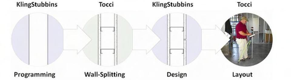

We knew from the start that we would eventually model walls as three components, in the method ala construction, but we couldn’t figure out when. We ended up doing it a few weeks before the permit set went out. After a few discussions, we agreed on a multi-step plan to do this. The process was too lengthy to describe, but it started with KlingStubbins doing some organization work in the model with walls (setting wall location as: Core Centerline). Then, I came in and started "breaking". I had a very systematic approach, included both tracking progress and accuracy in Revit and on a printed 2D RCP (with several colors of highlighter, of course).
Figure 3: Illustrating the wall breaking concept
The resulting walls were a little bit more difficult to work with, but we made do. Although there were some issues with graphics (in a view set to coarse, the edge of each wall can still be seen, making drawings look "muddy"), I think they made detailing wall sections slightly easier (at least that is what KlingStubbins said!). And the walls made construction much more streamlined; we used the model for partition layout (direct to Total Station) and visual scheduling.

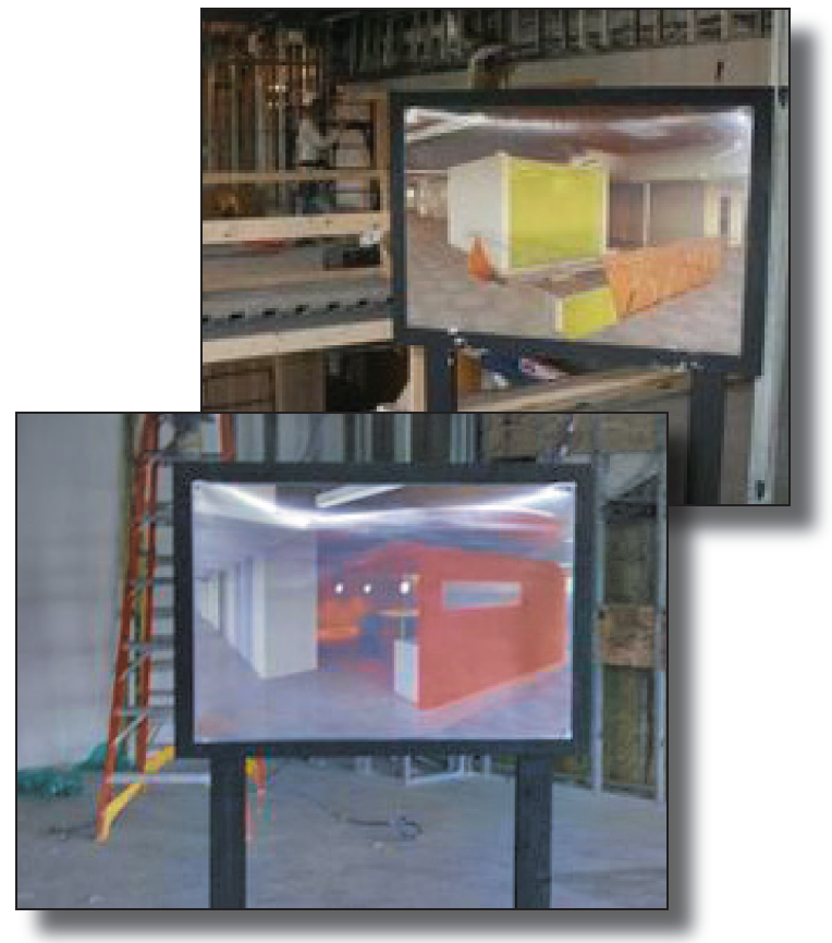

Naturally there is a great deal more I could write about our experiences once we got to work on site. I’ll touch on just one for this article. We posted these renderings on site (See Figure 4 and Figure 5), so that the field staff would have a better sense of the overall design intent for the affected areas.
Figure 4 & 5: Renderings installed on-site
For this project, we placed between 12 and 14 renderings on site. Even though we have a shared model with KlingStubbins, these are Tocci-produced renderings. We definitely benefited from the renderings that KlingStubbins did during design because a lot of the custom materials were already set up and we had access to all of the JPGs KlingStubbins used.
It was really exciting to place the boards on site - when I placed them, the drywaller came over and started discussing how the cantilevered piece of the curved wall could be supported as well as the ideal sequence for installing the drywall and the metal ceilings. It was exactly what we were hoping would happen!
