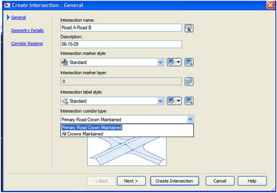

You will then be prompted to select the exact point where your two alignments intersect and then select the "main road" alignment. This will be used to determine how the intersection is ultimately warped: are you going to hold crown for the main road or warp the entire intersection?
After making those two selections, your Create Intersection – General dialog box will appear where you are then prompted to give your intersection a name, description, marker, and label style and determine how the road is to be crowned (see below).
Click "Next."

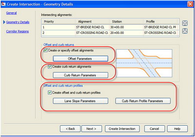

Let's begin to explore the power and ease of use of the wizard by first checking the "Create or specify offset alignments" and select the Offset Parameters button (see below).
This will create your curb return alignments and then you can generate profiles in order to manipulate the design of your intersection as needed.

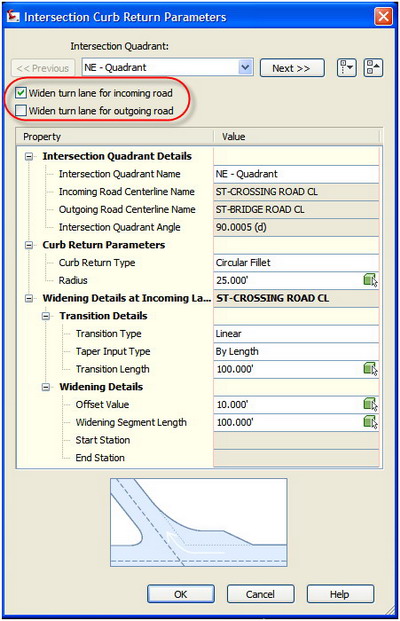

Next check the "Create curb return alignments" box and select the Curb Return Parameters button (see below).
Within this dialog box, you can specify the radius of EACH quadrant of the intersection separately. You can also choose to add a widening for incoming or outgoing lanes, if you happen to check these options highlighted at the top of the above screen capture, then you can specify how far of an offset and what the transition widening length is supposed to be per your design.

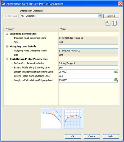

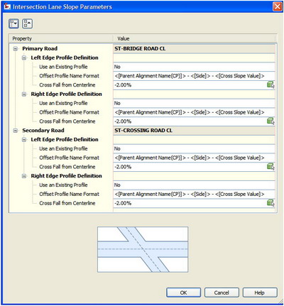

On the Create Intersection – Geometry Details dialog box, now you want to check the "Create offset and curb return profiles" box and select the Lane Slope Parameters button (see below).
Within the above dialog box you will have the ability to vary your cross fall from the centerline of your roadway design. You can chose to vary it with a constant cross fall of, say, 1.5 percent or link the cross fall to an already generated profile for vertical transitioning.
When you have completed the Intersection Lane Slope Parameters, select OK and NEXT to the Create Intersection – Geometry Details dialog box.

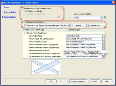

Above is the last step before AutoCAD Civil 3D will create your intersection object for you. At the top of the Create Intersection – Corridor Regions dialog box, you can first determine if you want to create a new corridor out of your intersection or if you want to add the data to an already created corridor model that you have run up to the start point of the intersection.
Next, if your corridor model has a daylight subassembly built into it, you can choose which surface object to which you wish to daylight. Finally, you can choose an already defined assembly set to use for your roadway design. If you have created all the necessary assemblies for your design, you can path them to the correct portion of the intersection and hit the "Save as a set…" button to make these assemblies in your drawing available for other intersection design projects.
