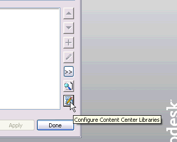

Project file configuration
Performance can be improved by creating separate project files for different design workflows. The project file may be identical to other project files (in fact, it is recommended to use the single project file approach), except in the area of configured Content Center libraries. Reducing the number of configured libraries will improve the load times when Content Center is used.
To configure the Project for Content Center, select the icon in the lower right corner of the Projects dialog box. You will then need to add desired databases into the project.
