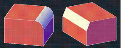

Solid editing has new finishing tools. In the Solid tab on the ribbon you will find the new Fillet Edge and Chamfer Edge commands. They work just like their 2D cousins, but in three dimensions. They also have a preview feature that helps you make sure you have things set right before you edit the 3D model you are trying to fillet or chamfer.
Figure 2 (Click to enlarge): Use the Fillet Edge or Chamfer Edge commands to modify 3D objects.
