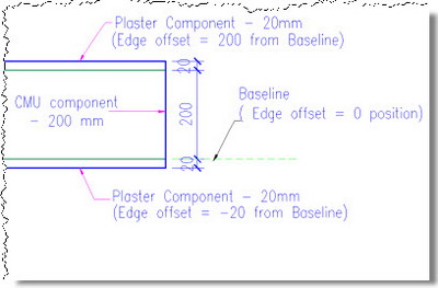

Let us continue from the wall style (P20-CMU200-P20-1h) we created in the Januarylesson. We have three components (the CMU and plaster on both sides) for which we have to apply hatches. Here is a snapshot of the wall style we created earlier.

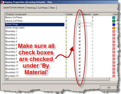

In the earlier exercise, we specified our own colors for the wall directly through the display properties. But for this exercise, we will ensure that all components of the walls are set to "By material." This is because we are going to allow the material to take control of the wall display. To ensure this:

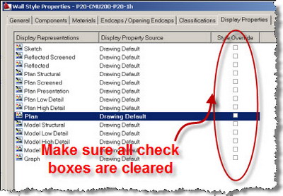

  • In the drawing area, select the wall (of style P20-CMU200-P20-1h), right-click, and select Edit Wall Style. Before doing this, ensure that you have at least drawn one wall in the drawing, which is of style P20-CMU200-P20-1h.
  • You will see the Wall Style properties dialog open. Click the Display properties tab.
  • Under Style Override, ensure that all check boxes are clear (i.e., no display representations are overridden).
  • Select Plan under Display representations column and click the Edit Display properties button in the top right corner of the dialog box. You will see the Display Properties dialog open up.
  • Ensure that "By material" is checked for all components. Refer to the figure above.

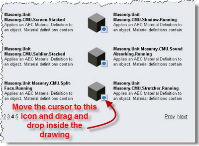

  • Then click AEC Material Tools - US metric - Masonry - Unit Masonry.
In the fourth page or so, you will see the material 'Masonry.Unit Masonry.CMU.Stretcher.Running'. (I use the metric content library as an example here.)
  • Drag and drop the material into the drawing area. Refer to the figure above.

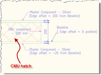

  • At the "Select a component or an object:" prompt, select the CMU component of the wall. (As you move the cursor near the wall, you can see the CMU component getting highlighted.)
  • At the "Apply the material to the style or [this Object]:" prompt, press enter.
You can see the material getting applied to the CMU component of the wall and the hatch for the CMU component appears.

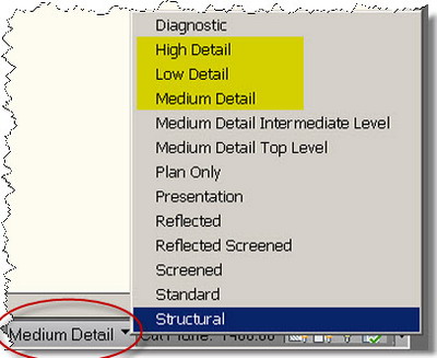

  • Now try to change the display configuration of the drawing from Medium Detail to High Detail, Low Detail, etc. (You can access this at the drawing status bar.)
You will see that the hatch scale changes accordingly as you change the display configuration. Now let us proceed to apply a material for the plaster components. This time, we will create our own material definition rather than getting it from library.

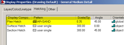

  • Click the Hatching tab.
  • Under pattern, click on "user single."
  • The "Hatch pattern" dialog opens up.
  • Select AR-SAND pattern from the predefined group.
  • For scale, specify "0.35".
Here, you can see the three types of hatches controlled by the material namely plan, surface, and section hatch.

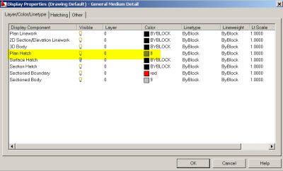

  • Click the 'Layer/Color/Linetype' tab.
Here, you can see the various components controlled by the material definition like, Plan Linework, 2DSection/Elevation Linework, Plan Hatch, surface hatch, section hatch, sectioned body etc.
Also note that the 'Surface Hatch' component is switched off .This way, we can avoid the display of the AR-SAND hatch on the wall, whenever you switch to a 3d view in a wireframe mode.
  • For the plan hatch, change the color to '8'.

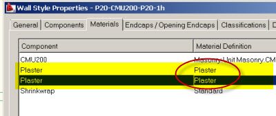

  • In the "Wall Style properties" dialog, click the Material tab.
  • For both the Plaster wall components, change the material to Plaster (the material you just created).
  • Click OK to close the dialog.

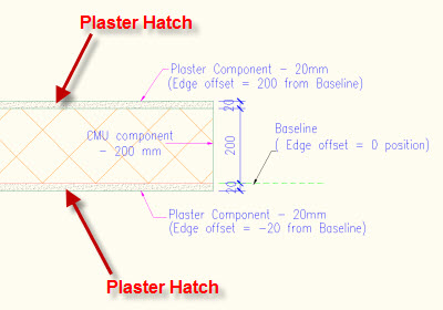

You can see the wall style getting updated in the drawing.
Try changing the drawing Display Configuration to High Detail, Medium Detail, and so on. You will see the plaster hatch change the scale automatically (.35 and 0.2).
