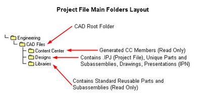

Perhaps the best approach to data management in Inventor is to use the Single Project File approach, not to be confused with Single-User Projects. The Single Project File approach works for all types of project files.
In this approach, a single workspace is utilized. A workspace is defined by the location of the project file itself. In the layout illustration below, the workspace is the folder called Designs. You will notice that folders for Library parts or generated Content Center members are located in the same tree level as the Designs folder. This folder structure creates a read-only relationship with the Content Center and Libraries relative to the Designs folder.

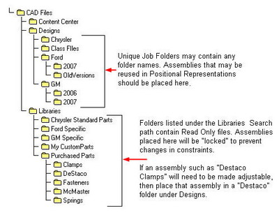

Next, determine how you will structure your individual jobs. Various companies have different methods for differentiating customers and/or jobs within the data structure. The illustration below shows one method in which jobs are segregated by customer and by year. You can structure your individual jobs pretty much any way that you like as long as the job folder is located within designs. The Designs folder creates a relative file search path environment for the unique parts stored within that folder.
Content Center and Libraries are a different matter. Content center components are non-unique members generated by the content centered databases in use. Content center components are reusable for the most part by any customer jobs. The generated members are stored in a common location, separated by database and by category. Content Center members generated in this environment are read-only, but will be reused if the same family selection is accessed again.
The general top-level Libraries folder contains subfolders for segregating reusable components. Subfolders may be created to make access to particular files easier. The image below illustrates a few different types of subfolder names that should be descriptive of the contents. Any component placed in the Libraries search path will be read-only in the context of this project, and like Content Center components, will be referenced within any assembly with an absolute file search path, ensuring rapid, direct access to the components when the assembly file is loaded.

- Create a new data structure utilizing the structure illustrated in the first image. Move your Content Center subfolders and files into the new data structure - Content Center main folder.
- Move your Library subfolders, restructuring and renaming subfolders as needed into the Libraries project subfolder.

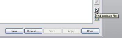

Next, within your new project file dialog, select the icon as shown below to check for duplicate filenames.
- Examine every duplicate filename and determine which file is the correct file. Remove the duplicates by moving them to a safe location outside of the new project search path. This will allow you to substitute a duplicate for the one that you have chosen, just in case you pick the wrong one.
- Once you remove the duplicates, start moving jobs into the Designs folder, creating subfolders as you go to support your new folder structure.
- Open each job assembly and drawing file, making sure that all missing files have been resolved before saving.
