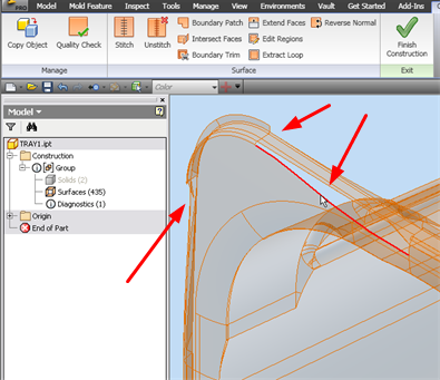

Now that the original instance has been deleted, we are ready to edit the composite in the Construction Environment. Right-click on the Construction folder and select Edit Construction. You will see that when you select the Construction folder, the part instance will be highlighted, as shown below.
In this example you will see that there are two solids and 435 surfaces, which together compose this model. A Composite is also known as a collection of surfaces stitched together into one or more surface quilts. Further analyzing this model by changing the visibility of the surfaces, I find that the two solids are very small objects along one upper edge of the tray.

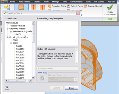

The next step in analyzing the model will be to perform a quality check. Pick on the Quality Check icon, and Crossing Window (right to left) all of the objects in the graphic screen. Once all of the objects have been selected, pick Examine to perform the Quality Check.
The results of performing the Quality Check on this model are shown below. You will note that the dialog shows two bodies with issues. The first issue is a body with self-intersecting surfaces that must be repaired. The second issue describes a Modeling Uncertainty containing numerous faces that may have errors. These errors could be gaps between surfaces, quite often being missing surfaces.
Let's try to correct the errors by selecting the first error message in the list, which in this file would be the self-intersecting surfaces. Select the body in the dialog box and pick Refit Body.
Autodesk Inventor will now attempt to refit this body using the Maximum Tolerance indicated. If this repairs that specific body, then it will disappear from the list as shown below. Once the first body is repaired, and is removed from the list, we can then attempt to do the same on the second body.
Note that the refit on the second body fails. This is more than likely due to missing or corrupt surfaces. In this model, the default maximum tolerance is listed as 0.010 mm. As a test, I will reset the maximum tolerance to 10x or o.10 mm, and attempt to refit the body once again. This attempt also fails.
A third attempt at 1.0 mm also fails, thus confirming my fears that there are missing surfaces in this model, as shown in the enlarged view below. Further analysis of this model shows that an excessive number of surfaces are missing. While this model could be repaired, given enough time, by selecting the Surfaces group in the construction environment, then right-clicking and selecting the Copy Object command which would then copy the surface folder to the Modeling Environment.
