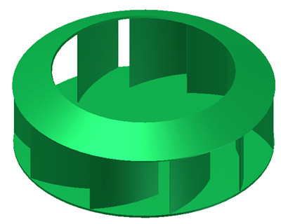

In the following example we need to determine the maximum deflection and stress in the blades when the fan is operating at 2000 revs/min.

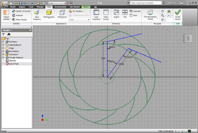

STEP 1 – Split the model so that only one blade remains
It will help to change the model display to wireframe or transparent color when creating the sketch as this will allow you to see the top plate and hence aid in positioning the split-line equally between the two blades. As there are 10 blades, we need to the split the model by a 360º angle.
Angle of Split to create single blade = 360º / No of blades 

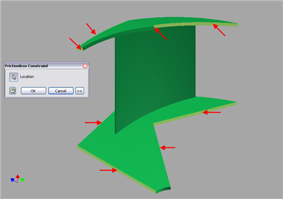

STEP 2 – Start Stress Analysis environment
First apply frictional constraints on all the split faces, eight in total. This will help treat the model as if it were not split. Then apply loads and restraints as normal.

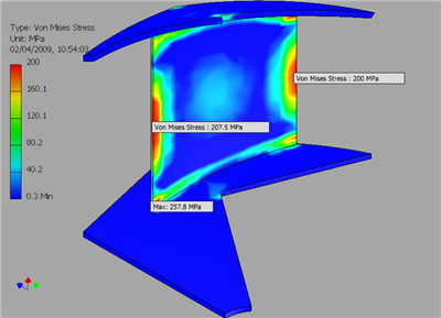

STEP 3a – Run and analyze results
High stresses may occur at the top and bottom plates where the frictional constraints have been applied. In the complete model these do not occur and can be disregarded. As the area of interest is in the middle of the blades, we can make use of the probes to determine the exact value of the stresses in this region. Also note there are high stresses at the intersection of the blades and top and bottom plates mainly due to geometrical discontinuity. Interpret results with care.
Tips on how to gain confidence in results when models have stress singularities
  1. Change the color bar max value to the material yield limit or to max required design value.
  2. Use probes to determine max value in the area of interest.
  3. Rerun analysis using a smaller global average element; I recommend half.
  4. Use local mesh control in the area of interest.
  5. Investigate the planar stresses, in addition to the von mises stress.

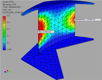

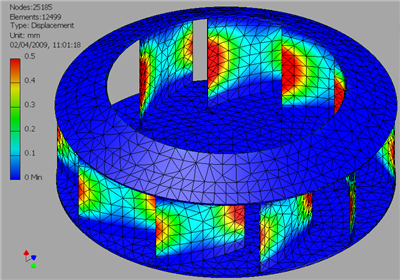

STEP 3b – Analyze deformation results
The max deformation occurs in the middle of the blade. As expected, the results are identical to the complete model. This hopefully will give you confidence that splitting the component - provided the loading, constraints, and geometry are symmetrical - will produce same results. This confidence in the results can be further enhanced by being able to refine the mesh further to see if the results have converged, without the fear of significantly increasing solution times and model sizes.
