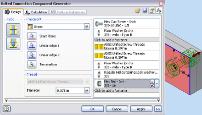

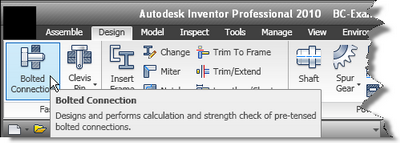

Using the Design Accelerator is essential to achieving full productivity when inserting standard fasteners. The Bolted Connection Wizard does virtually everything for you in many cases. In addition, it minimizes the number of assembly constraints when placing a fasteners set. The four images directly below illustrate the ease at which you can place a hole feature and all of the associated fastener components all at the same time.

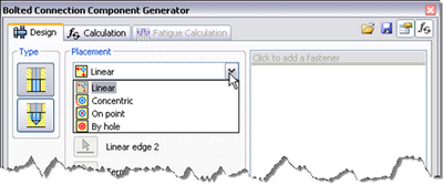

Multiple connection placement choices
The bolted connection generator allows component selection (click on image to enlarge it).

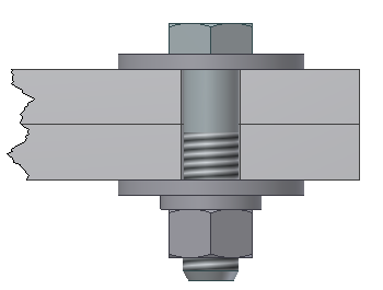

Cross-section showing all generated components

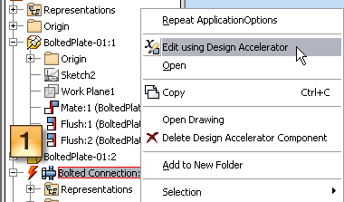

  1. Right Mouse Click on the Bolted connection that you would like to reuse. Select -Edit using Design Accelerator.

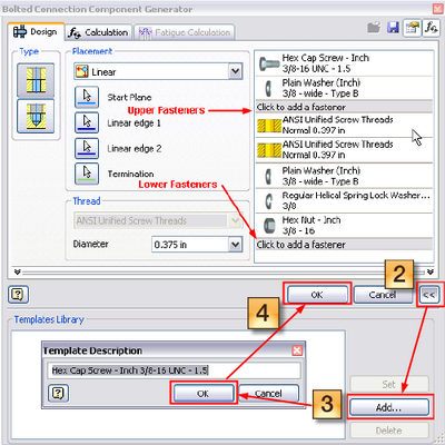

  2. Pick on the << Carat to expand the Dialog.
  3. Select Add to create a template of this connection. Please note that if you make changes to the connection, the Name description and the components in the template will automatically update.
  4. Pick OK to create the template.
  5. Pick OK to Exit the Dialog. The template is now available for reuse.Simply select the top face while in the Bolted Connection Wizard, in your template options will appear for selection. After selecting the template, pick the bottom face, then pick Apply, or OK to exit the wizard.

The issue is actually fairly simple to fix. Simply activate one of the bolted connections and update the connection. You will know which ones to change because there is a lightning bolt icon in front of the connection needing to be updated. If you have created a template to place the additional bolted connections, you will notice that the template itself will update with the proper length for the bolt needed for the increased thickness.
