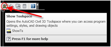

Upon opening up Civil 3D 2009, make sure that you have the Toolspace open for ease of navigation in the program. There are three ways to ensure that this dialog box is open.
  1. General pull-down menu --> Toolspace
  2. Type "showTS" into the command line
  3. On the Civil 3D Standard toolbar (see image below).

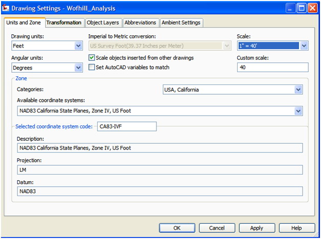

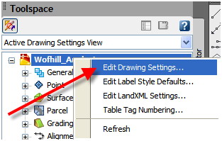

In order to set up your drawing settings (meaning the drawing scale, coordinate zone, object layers, units, and precision) you need to:
  1. Select your Settings Tab on your Toolspace (directly below the Prospector Tab).
  2. Right-click and select Edit Drawing Settings (see image below).

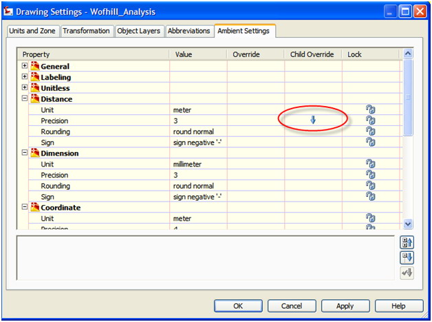

Once you have set up your drawing settings you are ready to begin to navigate through Civil 3D. One thing that needs to be understood is that Civil 3D works in a hierarchy from the Drawing Settings, which is at the top of the Settings Tab, to the individual objects down below. If you set up your Ambient Settings within your drawing settings to have a specific Unit, Precision, Rounding, and Sign at the drawing level, these settings will propagate to the individual Civil 3D Objects down below. One thing to note is that these drawing settings CAN be overwritten below in the hierarchy for the individual objects. Please see below for how to determine if a setting has been overwritten.
Keep in mind that if an entity is overwritten below in the hierarchy, you will receive the blue arrow in the Child Override column of your Ambient Settings. Unfortunately, there is no way to locate where this override is taking place, but you can select the blue arrow in the Child Override column and omit this override altogether.

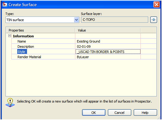

  1. In your Toolspace, select your Surfaces collection --> right-click and select Create Surface from the top of the list.
  2. In your Create Surface Dialog box you can give your surface a name, description, and style (to show how it will be displayed once you add your data to it), as shown below.

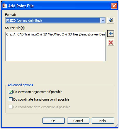

  3. Once the "shell" for your surface has been created, you can now add your data to build your model. Expand your newly created Existing Ground Surface --> Expand Definition --> Right-click on the Point Files collection and select Add, as shown below:
  4. Select the point format --> Hit the + sign and browse to the point file location. NOTE: You can select more than one point file at a time using the ctrl and/or shift keys.

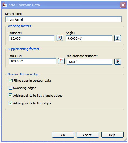

Building a Surface using Aerial Contour Data
  1. Please follow the above steps 1 and 2 to create a new surface shell.
  2. Once the shell for your surface has been created, you can now add the data to build your model. Expand your newly created Existing Ground Surface --> Expand Definition --> Right-click on the Contour collection and select Add, as shown below.
NOTE: In the "Add Contour Data" dialog box, you have the option to use weeding or supplementing factors to your data. This will weed out data if there appears to be an excess or add data to areas where this is not enough. The weeding factor is set to 15’ by default; this means that it will remove any vertices that are less than 15’ apart from one another. There are also tools to "Minimize flat areas by:" - commands include the following.
Filling Gaps In Contour Data - Specifies that small gaps in contours should be filled in.
Swapping Edges - Specifies that a non-contour common edge shared between a flat triangle and a non-flat triangle should be swapped.
Adding Points To Flat Triangle Edges - Specifies that a new point should be added at the midpoint of an edge shared between a flat triangle and a non-flat triangle.
Adding Points To Flat Edges - Specifies that a new point should be added to edges that bridge two same-elevation data contours and are not in flat triangles.

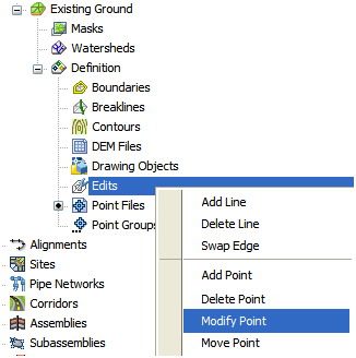

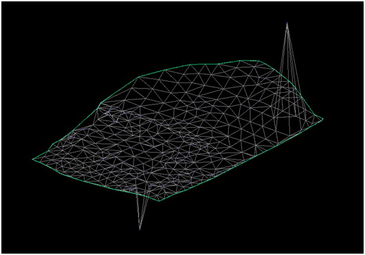

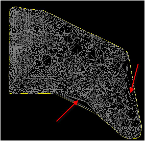

Our first editing technique will enable us to edit the TIN surface if there is a blown elevation or spike. See below.
  1. Expand your Existing Ground Surface --> Expand Definition --> Right-click on Edits --> Select Modify Point. See below.
  2. Select the erroneous point --> Hit enter --> Type in the correct elevation value --> Hit Enter and watch your surface automatically adjust.
The next editing technique is to delete TIN lines when your surface model is interpolating information in an area where you are lacking 3D data.
  1. Expand your Existing Ground Surface --> Expand Definition --> Right-click on Edits --> Select Delete. Hit C on your keyboard in order to use a crossing window to delete the necessary lines, as shown below.
  2. As you delete a group of lines you will need to Hit C to invoke the crossing window command again once you hit the enter key if you will see your border automatically adjust to fit your new surface model.

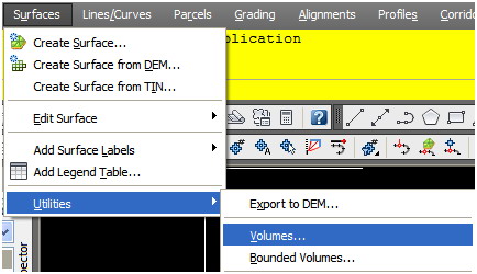

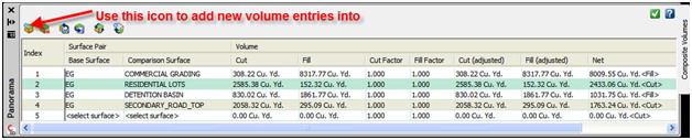

Surface Volume Tabular Method
  1. Go to your Surfaces pull-down menu --> Utilities --> Volumes, see below.
  2. In the Composite Volumes panorama window you are able to add multiple entries into the table to compare multiple design alternatives, see below:
NOTE: In the volumes table you do NOT have the ability to calculate Grid Volumes; you can ONLY calculate Composite Volumes. If you need to create a Grid Volume, use the process listed below.

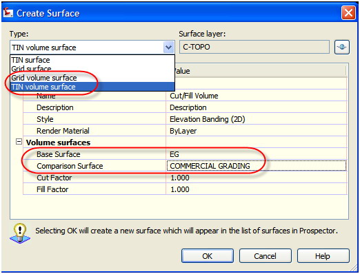

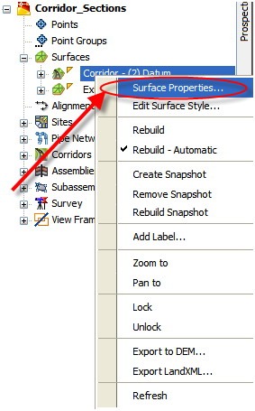

The next volume calculation method is to create a volume surface. This will allow you to create a cut/fill analysis or any other color banding that you wish to create. Using this method you will be creating a model to display your volume information as opposed to the previous method that simply supplied you with calculations in a grid view.
  1. Create a new surface by right-clicking on Surfaces in your Prospector tab of your toolspace. (Refer to surface creating techniques discussed previously in this guide.) See below.
  2. Make sure to select either Grid or TIN (Composite) volume surface.
  3. Select your Existing Surface for your Base Surface and your design for Comparison Surface.
NOTE: You can adjust your Cut and Fill Factors to account for shrinkage or expansion.

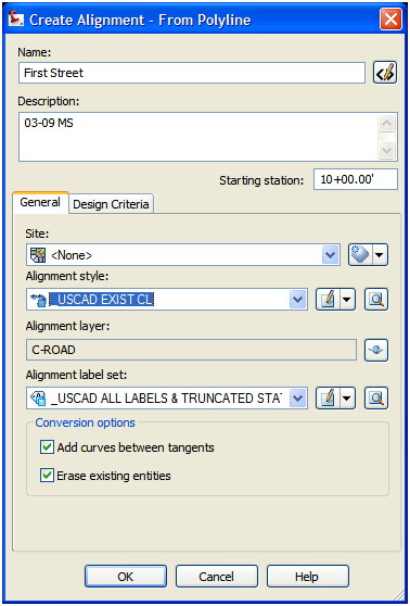

  1. Go to your Alignments pull-down menu --> Create Alignment from Polyline. (You must have your polyline in your drawing before beginning this command.)
    NOTE: It does NOT matter in which direction the polyline was originally drawn - you simply select which end to begin your alignment stationing.
  2. Select your polyline that you wish to turn into an alignment object, as shown below.
NOTE: When creating an alignment object from an existing polyline, you have two conversion options at the bottom of the Create Alignment dialog box. You can choose to delete your original linework and add curves between tangent lines. We will next explore how to edit your alignment geometry in both graphical and tabular form to cycle through design alternatives.

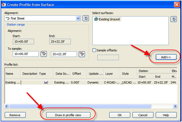

Creating an Existing Ground Profile in Civil 3D is not only an extremely easy task as profile generation has a wizard to walk you through the steps with ease, but the fact that your profiles in Civil 3D are dynamic with your surface and horizontal geometry make your design tasks that much more fluid and less erroneous. Before creating a profile object inside of Civil 3D, you must first have a surface model for your 3D data and an alignment object for your horizontal data. We have explained how you create these necessary objects above.

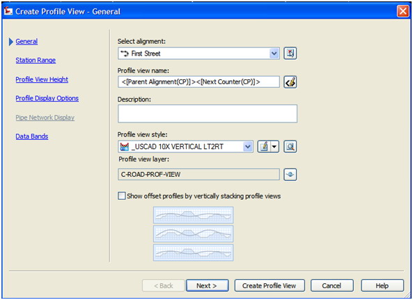

  1. Go to your Profiles pull-down menu --> Create from Surface, select your Alignment and Surface and hit the Add button and hit the Draw in profile view to see your existing ground profile in a grid.

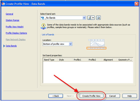

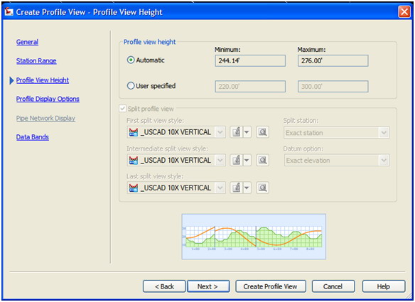

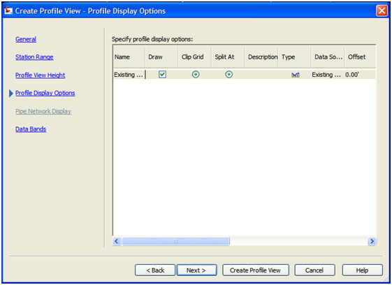

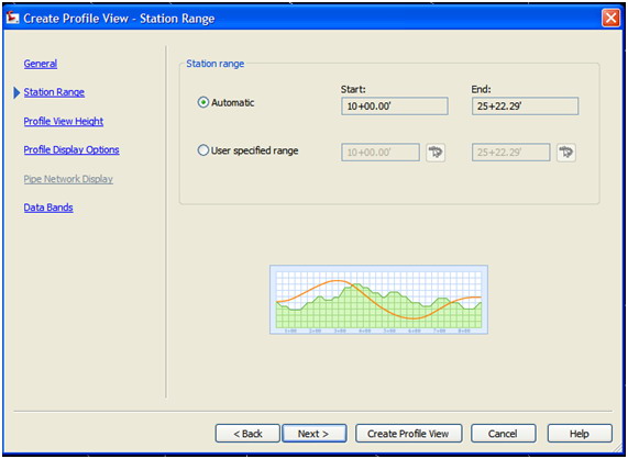

  2. This will then take you into the Profile View Wizard that will walk you through the process of creating a profile view. You will accept the default settings for your first attempt and ease of use. See below.
  3. Hit the Create Profile View button and place your profile somewhere in your drawing. Not to worry... if the location of your profile needs to change, just use the grip or AutoCAD move command to relocate it at anytime without repercussions. Also, if your horizontal alignment or existing ground surface happen to change, your profile will be dynamically updated.
