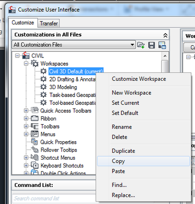

To get started customizing our ribbon or workspaces, type in "cui." Once the customize user interface editor opens, you will see workspaces located at the top. This is what we will be customizing. We also have the option of creating new workspaces, or copying one of the existing workspaces and then customizing the copy, retaining the original workspaces. I suggest that create a copy and modify it instead of changing one of the defaults, until you are comfortable with making changes in the CUI. Pick one of the workspaces and right click, to choose copy, then right-click on the copy and set the copy to current, or edit the one you have set to current.

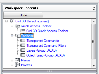

Another option is to go into the CUI and add the toolbars here. Choose a workspace to customize on the right side and while in customization, go back to the right side, expand toolbars and select the ones you want, then click done. You will very likely have to expand the partial customization files located at the bottom of the list to find the toolbars you would like to activate. This method is a little easier than the first option!

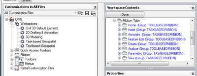

Partial customization files
One tip is that some of the changes can only be made in the lower set of customization files. This is particularly true with Map 3D. I have a tip to make this a little easier. While customizing a workspace you can check to see where you should be making your changes by looking at the list in Workspace contents - some of these will belong to one group or another. For example, Map task-based workspace changes need to be made in the task-based ribbon CUI, as shown below. You will notice that after the ribbon tab's name is additional information, which is showing where the ribbon or other feature is located and where the changes need to be made.
