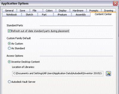

When you go to Application Options, you will notice that there is a new tab in options for 2010. Be sure to configure this before attempting to use Content Center components in your new design. The Content Center tab is shown below.

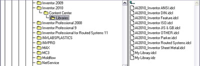

The image above illustrates the correct settings for use. If you have difficulty in placing or accessing content center in 2010, you will want to verify that the location of the installed libraries matches the location specified in this dialog box. Libraries that should be installed on your system are shown in the image below.
Desktop Content libraries do not follow the same format as previous Content Center libraries - they are different file types with different extension names. The IDCL extension is new for Inventor 2010 and does not require ADMS to deliver the content.
You'll notice that the standard list of libraries that are installed also include a custom read/write library called "My Library." Additional custom libraries may be created through the project file interface.

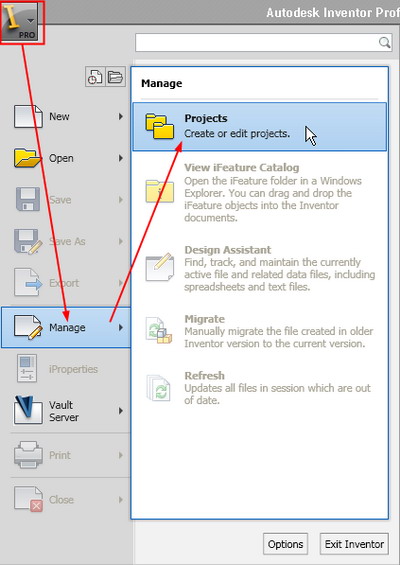

Configuration of Content Center in project files has changed for Inventor 2010. To access projects in Inventor 2010, go to File >> Projects in the Classic interface, or select the Inventor Icon (upper left corner of your screen) >> Manage >> Projects, as shown below.

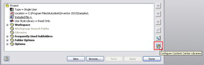

In the projects dialog box, you may configure the Content Center libraries by picking on the icon in the lower right corner as shown below.
When you launch configuration, you will be presented with a configuration dialog that will allow you to easily select the particular library(ies) that you want to use within this project. This is a much simpler approach than in previous versions. Instead of adding or removing libraries, you simply place a check box in front of the desired active libraries. In the image below you will notice that there are two unchecked libraries that are custom libraries, allowing for creation or addition of user content.
Content Center libraries, like all other aspects of the project file, are stored within the individual project file. Once you have properly configured for desktop Content Center, the available content is accessible through the right-click menu in the assembly environment.
