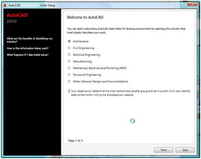

One of the first things you'll notice is that during installation, you're given a choice: you can select from six different industries (or Other: General Design and Documentation), which will affect the Initial Setup of your drawing environment. Don't worry if you miss it during installation because it'll still be available via the Options dialog (User Preferences tab).
This results in a new workspace, but you can quickly and easily modify the workspace or switch to one of the defaults such as 2D Drafting & Annotation, 3D Modeling, or AutoCAD Classic.

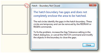

I really like this one... if Hatch can't find a valid boundary area, it will try to flag a problem area (showing red circles around suspected gaps). You can also edit hatches that aren't associative, using grips.
