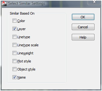

Select Similar gives users the ability to automatically select objects with similar traits. There are two main ways to activate this tool: select an object and right-click, or type selectsimilar on the command line. The right click method will bring up the right-click shortcut menu. Move down the list until you find the Select Similar option and pick it. According to the filter settings, every object that is similar (in the file) will automatically be selected. This tool can help you select all of the hatch patterns in a few clicks. If you type the command in you will then pick your object to use as a filter, press enter, and away you go.
Selecting more than one object will better define what objects you are going to pick - and don't forget the filters (see Figure 1). You can filter objects according to Color, Layer, Linetype, Linetype Scale, Lineweight, Plot Style, Object Style, and Name. Toggle on or off any combination of these settings that you want to use. The default settings come with Layer and Name as on, all others are off. That means that if you select a hatch object, then all hatch objects on that layer will be selected. If you pick two hatch patterns, each on different layers, then every hatch on both layers will be selected. The more objects you select, the more criteria you add to the filter. But if you pick different object types, a hatch and a region, that are different layers, they won't overlap. That means that the hatch patterns will have to be on the hatch's layer and regions have to be on the regions layer.
Most of the filters are self-explanatory. Color selects objects based on their color. If they are set to bylayer, then only bylayer objects will be selected. Object style applies to objects that have styles, such as text or dimensions. To gain access to the filter list, type SELECTSIMILAR on the command line. You then have the option to select your filter object, or to type SE to get to the settings. A window will open up where you can pick the filters you want to use.
Figure 1: The Select Similar Settings window allows you to set the automatic selection filters that you want to use.

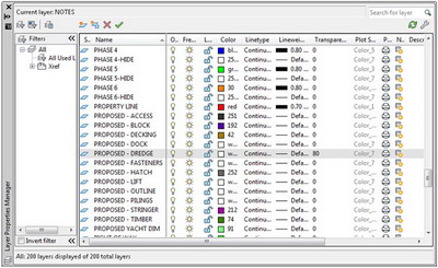

Transparency
AutoCAD added a new object property called Transparency, a setting that allows you to make an object or objects translucent. It can be assigned to objects or layers just like color and linetype are. The new property has been added to the Layer Manager and its value can be assigned to layers and controlled through Viewport transparency, just like View Port Color or linetypes are assigned. The default value for an object is Zero, for no transparency. The value spans from zero to 90. You cannot make an object 100 percent transparent, however. The highest value is 90, or 90% transparent. Each value for the setting is a percent. Zero percent means it has no see through (or transparency) traits at all.
Figure 3: Click image to enlarge The layer manager can control the transparency settings of your objects. Transparency can also be set per object.
