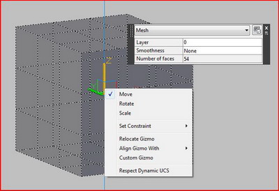

To activate a gizmo, pick the one you want to use from the Subobject panel in the ribbon. It can be found in the Home tab and the Mesh Model Tab in the 3D workspace. Clicking the Gizmo icon will open up a pull-down menu listing each gizmo, plus a setting for No Gizmo. The one you pick will be the gizmo invoked when you select an object while working in a 3D visual style. If you want to use the 3D Move gizmo but have the 3D Scale gizmo activated when you select an object, just right-click the gizmo to bring up the 3D Gizmo shortcut menu. Here you can change gizmos and constrain, relocate, or align your gizmo.
Figure 2: Right-click on the active gizmo to bring up the gizmo shortcut menu.

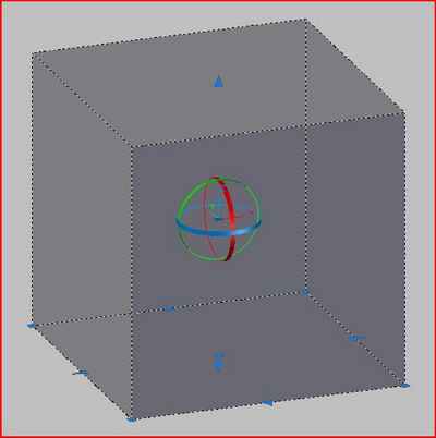

The 3DRotate gizmo, like the 3DMove gizmo, works in a similar fashion to the 3DROTATE command, but with less clicking and picking. When started, an orbital axis appears centered in the selected object. Just like in the 3D Move gizmo, you select the axis around which you want to rotate your object. Your object is constrained to that axis.
Figure 4: The 3DRotate gizmo.

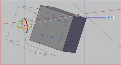

The 3DRotate gizmo can be relocated just like the 3DMove gizmo can. This allows you to rotate your object along an axis that is not based in the center of the object. You can either right-click the gizmo to select the Relocate Gizmo option, or click and drag the center of the gizmo to its new location.
Figure 5: Relocate the 3DRotate Gizmo to rotate your object along a different axis.

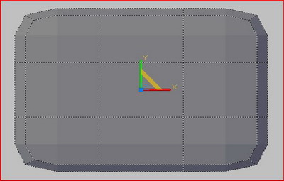

This gizmo is all new in AutoCAD 2010 and it works just like the other gizmos, only it scales objects instead of moving them. Start the 3DScale gizmo just like you do the other gizmos. It also has an axis icon that you can select. Pick the Y axis to scale your object across the Y axis only, pick the X axis to... well, you get the idea. This gizmo can also be relocated (right-click just as with the other gizmos). As with the other gizmos, in order to scale across more than one axis select the triangle (not the square this time) closest to the axis. This will constrain all three axis to scale along. If you want to scale across two axis, select the area just above the triangle.
Figure 6: Select the area above the lower triangle to scale an object along two axes.
